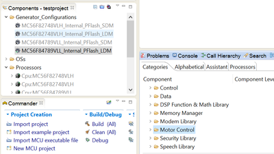

dear NXP expert, I need use FFT function on MC56F82748,but only when I set the processor as MC56F84789 I can find the DSP Function & Math Library item. pls tell me how to find the DSP Function & Math Library in processor expert component when MC56F82748 chosen. thanks.

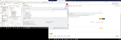

I have checked my PE based on MC56F82748, it has DSP Function&math Lil exactly. I attach my screenshot here. If your PE have not, pls try to install by clicking Help->Install New Software.
Hope it can hlp you
Xiangjun Rong

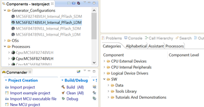

terrybogard
hi ,xiangjun,
I found the component view default setting
Filters: show only components available for processor in focused project.
if it was not chosen, the DSP Function & Math Library would show.
so it does mean the DSP Function & Math Library is not available for 82748?
Terry Bogard

terrybogard
yes, if don't choose the filter, it can be found. but does it  mean the DSP Function & Math Library is not available for 82748?
