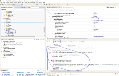

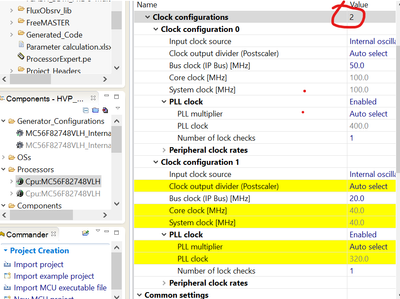

dear nxp expert,
when I use processor expert to configure clock of MC56F82748, I set Clock configurations as 2, then come out configuration 0 and configuration 1. so what's the difference between 0 and 1? and why this can be set as 2, I found most demo project is 1.

Pls refer to the screenshot, if you add more clock configuration, the PE will generate more clock configuration, you can call the CPU_SetClockConfiguration(LDD_TClockConfiguration ModeID) to select one.
Hope it can help you
