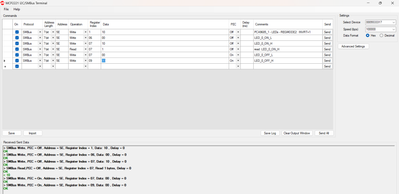

I tried what you suggest just for led 0 but nothing is happening. Following the commands I send and the device responses:
One think to consider, looking to the schematic , the LEDS power supply is not Vdd of the PCA9865 chip (3,3V) but its 5V...dont think this is an issue since I configure the GPIO like opendrain .
As you can see I correctly write LED0_ON_L=0x00 and LED0_ON_H=0x10 and i can even read the value back of the LED_ON_H back  and just written correctly: im sorry but nothing happens into my board.
Traces on the PCB seems to be ok infact when i give power to the board , all RED led are on (dont know whyhonestly) , but when i send the first command (INVRT=1), they goes all down.
Do you have some ideas? Is the schematic the issue?

I did a step further , I can switch on/off every LED0 channel (RED LED) in open drain configuration by :
deleting the sleep bit: MODE1=0x01
and by switching the LED0_OFF_H from 0x10 (off) to 0x00 (on)
I cant figure out why this configuration doesnt work for other LEDn.
I will try to investigate why by checking the PCB which seems to be ok ,  before to pull to 3,3V (Vdd) each leds and try the pushpull configuration you suggest.
