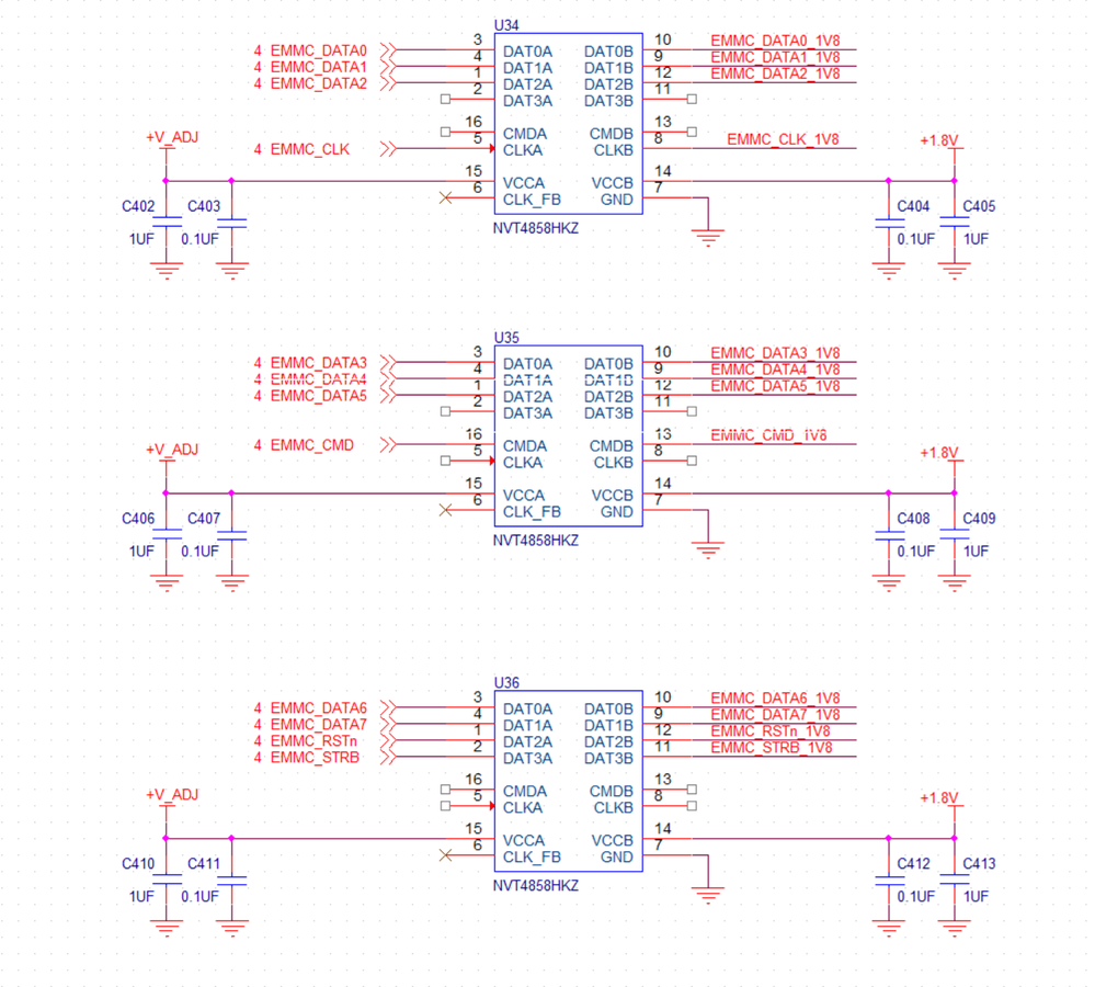

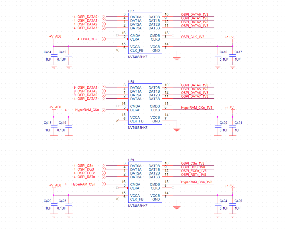

    I am using NVT4858 as the level shifter for eMMC and OSPI. The circuit schematic is as follows: May I ask how to deal with the unused CLK, CMD and DATA pins? Is it OK just to unconnected? Please give your suggestions on the following circuit. Thank you.

To add: +V_ADJ is 1.2V. The NVT4858 converts eMMC and OSPI from 1.2V to 1.8V. Thanks.
