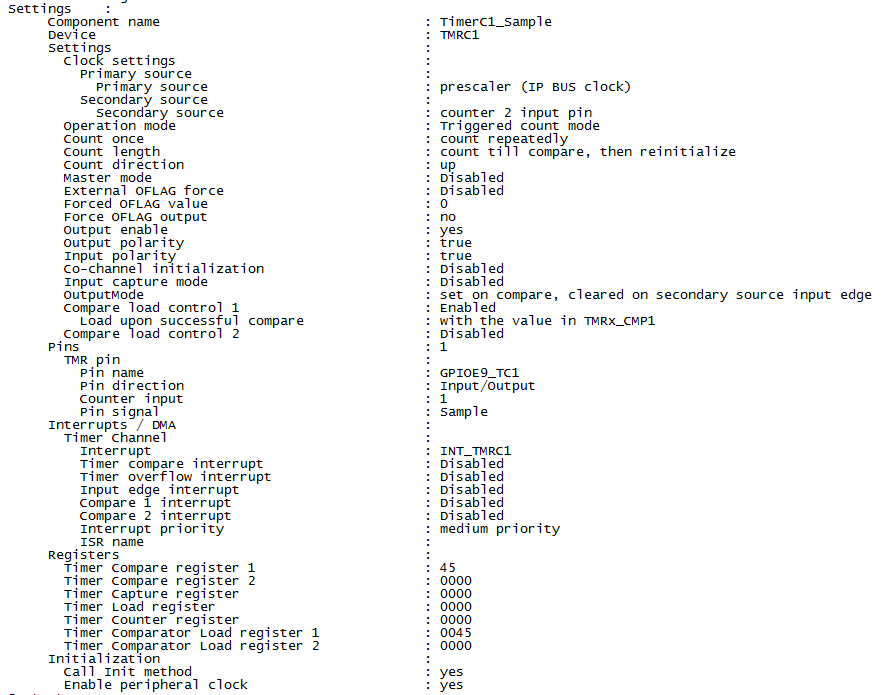

 I try to setting timer C1 using CW 10.7 PE, but cannot set it to be triggered by C2 output and counts a number of IFbus pulses and output from TC1 to external circuit when success compare, the second source is only list input pins, not output pin. Primary source cannot selected to trigger counting IFbus, Is there any body know how to set this up. It seems the timer does not behaviours as manual described.

Thank you for help, here is PE generated code, it does generate a pulse on TC1 pin, but I cannot change pulse width, when I change compare and compare load register values from 45 to 100. Also I tried different settings, none of them works as expected.
Jian Li

How about setting the output mode as "Toggle OFLAG output on successful compare"?
