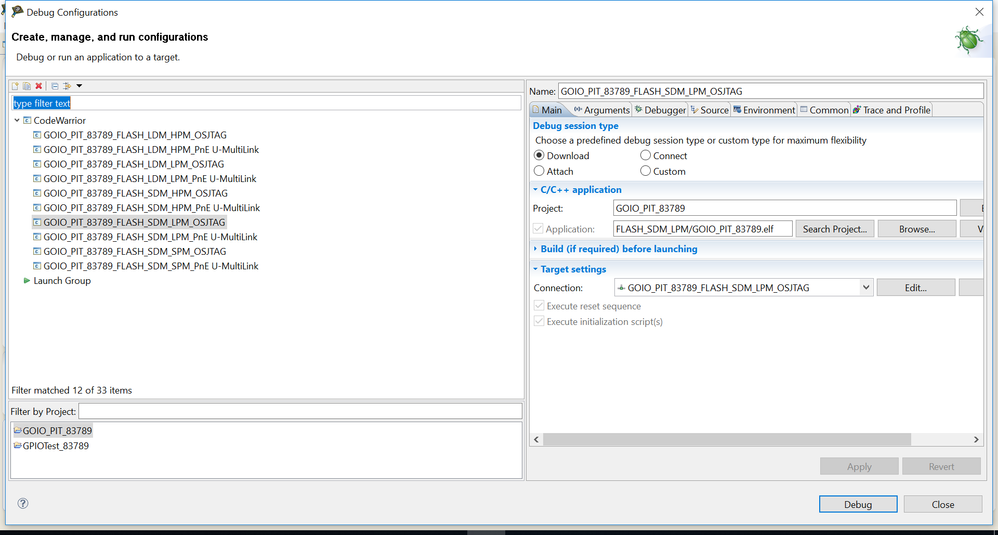

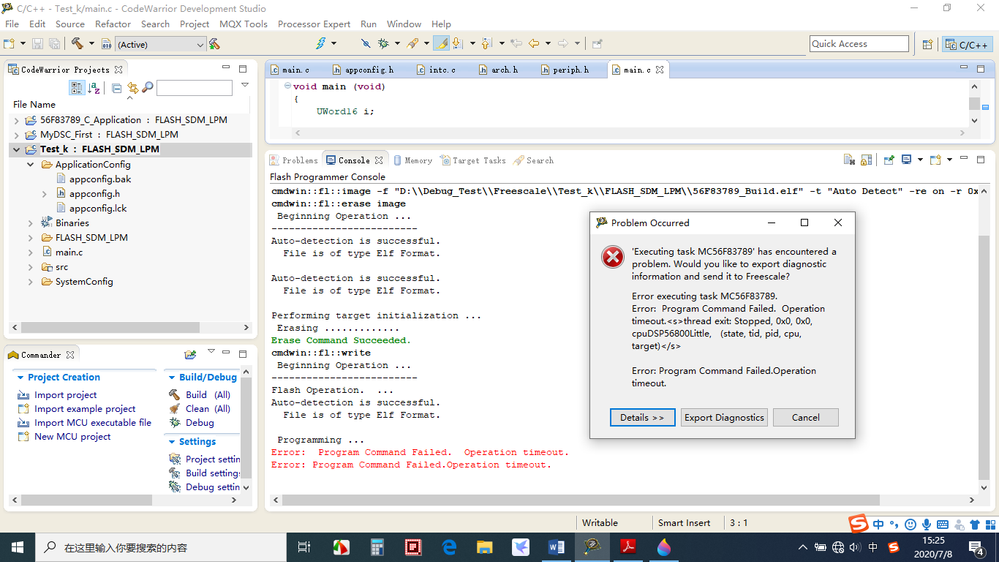

      I create one project about FRDM-56F83000 (File-> New -> Project -> New Stationery Project, MC56F83789 -> MC56F83000-EVK -> C_Application), then compiling and programming are normal. But I added any code in main() function, the project could compile, and it could not program(the error windows appears). Why about this?
      The attachment is the error information.

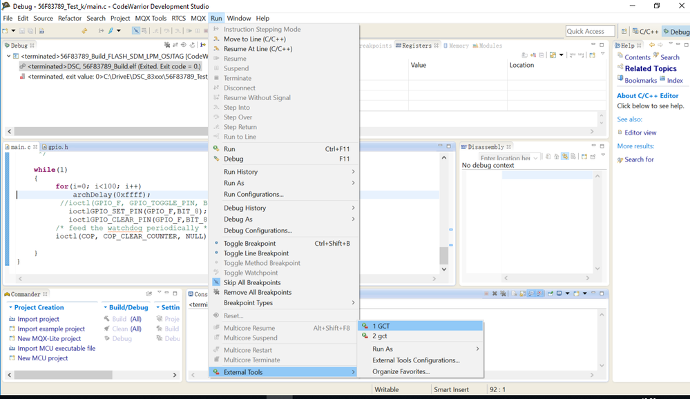

xiangjun_rong
Hi, Derek Xiang,
After I modified your code, I can debug your code as the screenshot.

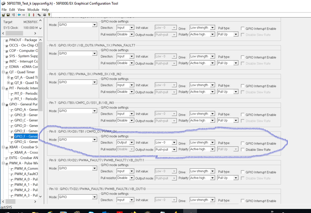

As I said, if you create a project based on Quick Start tools, you have to load the GCT and setting the GCT correctly.
Enable GPIOF gated clock in GCT tools
//set up GPIOF8 pin as output
//add the code in while(1):
            ioctlGPIO_SET_PIN(GPIO_F,BIT_8);
            ioctlGPIO_CLEAR_PIN(GPIO_F,BIT_8);

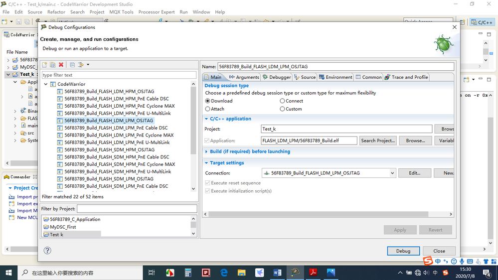

xiangjun_rong
Hi, Derek,
I have to make sure that the hardware connection is okay.
If you use on-board OSJTAG, you have to close J11 and inset USB cable to J8.
If you use Multilink Universal device, pls select Open J11 on the FRDM board, and select the ********U-Multilink as following Fig
Note that the USBTAP device is NOT supported for MC56F83xxx family.
Hope it can help you
Xiangjun Rong

DerekXiang
Hi, Xiangjun,
      I make sure that the hardware connection is okay.  I can program the other example code which was created by the other method.
     You need create the project by "New Stationery Project", then you could repeat this question.
      The following is the related  picture.

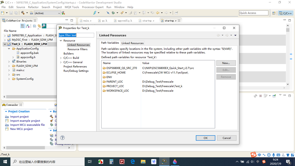

xiangjun_rong
Hi, Derek,
Regarding the project created with the procedure File-> New -> Project -> New Stationery Project, MC56F83789 -> MC56F83000-EVK -> C_Application, this is a template based on Quick_Start tools, if you use the project, you have to install the quick_start tools.
Pls refer to the attached doc for installing the quick_start tools.
