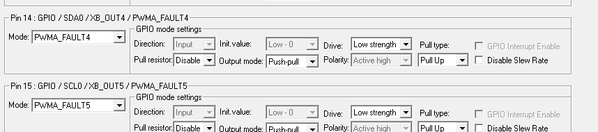

Have an issue that GPIO C14/C15 inputs are not enabling PWMs fault channels in GCT. Even though they are selected. im not able to get a check mark on the boxes
How can i manually enable them during initilisation process in main.c?
Im using MC56F837xx, CodeWarrior 11.1 and Quickstart 2.7

in GCT's SYS - System Support Control why cant I choose the fault pins for example on GPIOF5? It only shows GPIO G's faults. Which are not supported by my DSC type. I need to select them on GPIOC14, GPIOC15 and GIPIOF5
Also in SYS.h im not able to find register for GPIOF5.
The below code shows for GPIOG5. How can i select the register for GPIOF5?

xiangjun_rong
Hi, Fasih,
For the PWMA module of MC56F83xxx, there are 8 Faults pins, they are Fault 0/1/2/3 and Fault 4/5/6/7, for the Fault 0/1/2/3, there are TWO sources, one is from external pads, another is from crossbar, which one functions as Fault is dependent on the SIM->IPS0 register, that is why you are required to select the fault source for Fault 0/1/2/3 in SYS module.
For the Fault 4/5/6/7, there is only one source, external pads.
In conclusion, for fault 0/1/2/3, if you use external pads as fault pins, you are required to configure the SYS module and GPIO module, for example GPIO E8/E8 and G4/G5.
For the Fault 4/5/6/7, you are only required to set up the GPIO for example GPIO F4/F5..
