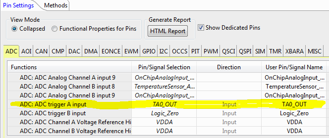

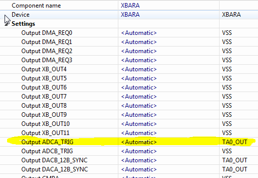

The error message seems to indicate that the XBARA is not set up properly.  So I added that component and the "Automatic" settings show that the timer I want to use is routed to the ADC.
Also the Pin Settings component shows the ADCA Trigger Input connected to TA0_OUT.

I think it is the PE bug for MC56F82xxx, as a workaround, I think you can write register directly so that the PIT or quadTimer can trigger ADC. for example, if you want to use TA0 to trigger ADC: XBARA_SEL6=14; initailize the TA0 module so that it can generate the signal at the sample cycle time.

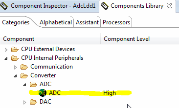

Thanks for the reply.  You set up a Logical Device Driver (LDD).   The problem occurs when the component is a High Level driver that uses the LDD (I want to use that one because it can do multiple samples and averaging).  This image shows what driver I am using.  Can you select that one and see what the results are?
When that component is set to the Internal Trigger Input that is when it cannot resolve the setting.
Is there any documentation that shows what "Routing peripheral is not selected/specified" is refering to in PE?
Also I did set up a separate project with just the ADC High level component and had the same problem.  If I disable the Internal Trigger then it is happy again but I want to trigger it off a timer.
