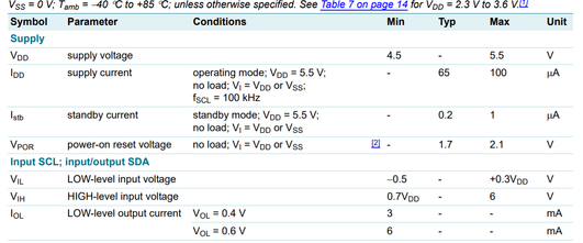

I need low and high level output voltage thresholds for SDA and SCL.
Supply voltage:3,3V
I could not find in datasheet.

You can download UM10204 (search in NXP website)the IIC spec for more detail information.
