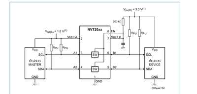

HI NXP team,
I have to translate the signal from 5V to 1.8V, I have connected the VrefB- 5V and VrefA-1.8V
Question -
Will it make any problem if I connect high-side portion to the I2C master and connect the low-side to I2C device ?
because I see in Application notes and Datasheet information show the low-side portion of the chip to be connected to the I2C master, while the high-side be the I2C device.
Thank you
2,265 Views
JozefKozon
Hi Pjanek,
no, there is no issue. You can connect I2C master on high side. Please note, that EN is controlled by the Vref(B) logic levels.
