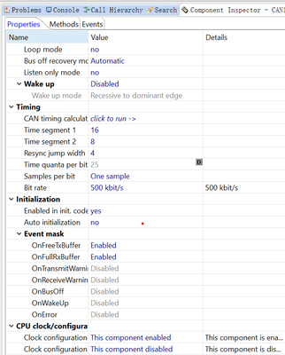

terrybogard
volatile bool DataFrameTxFlg;
LDD_TDeviceData *MyCANPtr;
LDD_TError Error;
LDD_CAN_TFrame Frame;
uint8_t OutData[4] = {0x04U, 0x08U, 0x0cU, 0x0fU}; /* Initialization of output data buffer */
void main(void)
/*** Processor Expert internal initialization. DON'T REMOVE THIS CODE!!! ***/
PE_low_level_init();
/*** End of Processor Expert internal initialization. ***/
MyCANPtr = CAN1_Init(NULL); /* Initialization of CAN1 component */
Frame.MessageID = 0x123U; /* Set Tx ID value - standard */
Frame.FrameType = LDD_CAN_DATA_FRAME; /* Specyfying type of Tx frame - Data frame */
Frame.Length = sizeof(OutData); /* Set number of bytes in data frame - 4B */
Frame.Data = OutData; /* Set pointer to OutData buffer */
DataFrameTxFlg = FALSE; /* Initialization of DataFrameTxFlg */
Error = CAN1_SendFrame(MyCANPtr, 0U, &Frame); /* Sends the data frame over buffer 0 */
while (!DataFrameTxFlg) { /* Wait until data frame is transmitted */
CAN1_Main(MyCANPtr);
Frame.MessageID = (0x123456U | LDD_CAN_MESSAGE_ID_EXT); /* Set Tx ID value - extended */
DataFrameTxFlg = FALSE; /* Clear DataFrameTxFlg */
for(;;) {}
Content of Event.c:
extern volatile bool DataFrameTxFlg;
void CAN2_OnFreeTxBuffer(LDD_TUserData *UserDataPtr, LDD_CAN_TMBIndex BufferIdx)
{  DataFrameTxFlg = TRUE; /* Set DataFrameTxFlg flag */}

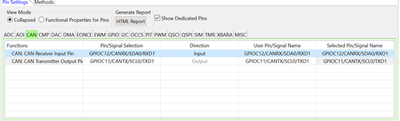

terrybogard
thx for Xiangjun's answer, i am sure i have done the pin assignment by processor expert as below.
when i debug, in CANTFLG register, TXE0 = 0 all the time: mean Transmit buffer full (not sent, scheduled).
