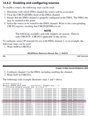

Hi NXP,
I am using MC56F83768 microcontroller and I want to use DMA to read data from SPI0, which is configured as a slave and only receives data. Is there any code example? Also, to set a proper SOURCE in DMAMUX, I need to know DMA request sources (slot numbers) for peripherals, which I couldn’t find in the MC56F83xxx Reference Manual.

You can use any DMA channel to transfer data from SPI0 receiver data reg to memory(array). For example, you use DMA channel 7
For MC56F83xxx, the SPI0 Receiver slot is 12, the SPI1 receiver slot is 14
You can write
*CHCFG7=1<<7|12; //for SPI0 receiver;
*CHCFG7=1<<7|14; //for SPI1 receiver;
Hope it can help you
XiangJun Rong

Thanks for your suggestions and apology for some delayed response – I was out of office for a few days.
I looked at driver examples for queud_spi and, actually, they cover both cases: master and slave spi. So, with some ideas from those examples and digging into the microcontroller’s manual, I got it working. I believe I should be all set (for now ).
