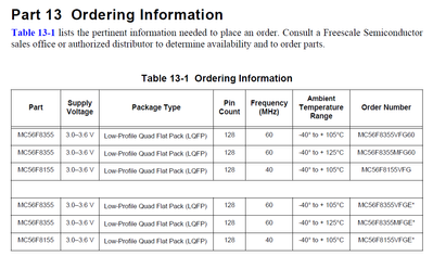

I use an MC56F8355 and it doesn't start when I heat it.
The RESET signal is OK but the RSTO signal stayes at 0.
Thank you for your help

I suppose that the MC56F8355 can run if you don't heat it.
This is the ambient temperature range the MC56F8355 can work.
Hope it can help you
XiangJun Rong

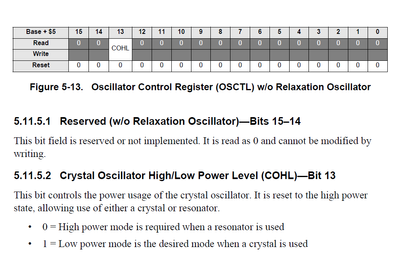

christophe_c
If the temperature is 25°C, it's OK.
If the temperature is 10°C or 50°C, it's not OK.
I changed crystal by a ceramic resonator 8MHz and I can start the µcontroller at 10 and 50°C.
Is it necessary to change the bit  register COHL which is at  1.

xiangjun_rong
If you use 8MHz ceramic resonator, I suppose the COHL bit should be cleared.
Pls refer to section 5.11.5 Oscillator Control Register w/o Relaxation Oscillator (OSCTL) in MC56F8300UM.pdf
