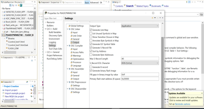

Dear NXP expert,
forMC56F82748,  how can i generate hex file not elf file by CW?

Hi, Adrian,
In CodeWarrior for MCU ver11.x, after you have compiled the project, pls click Project->Properties, the Property Menu will appear as following Fig. You can check the box, then recompile the project, the *.bin or S-Record file will be generated at the directory ...\FLASH_SDM directory or ...\FLASH_LDM
Hope it can help you

terrybogard
only bin file, can't hex file? and I need transfer bin to hex by other tools?

xiangjun_rong
Hi, Terry,
I think the answer is Yes, the CW tools only supports S-Record file and Bin file, it can not generate Hex file, you have to use the other tools to convert the *.bin file to hex file.
