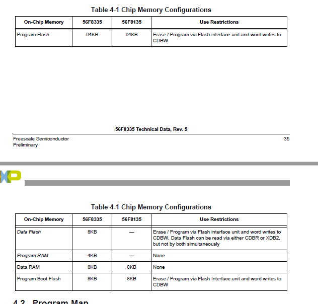

I attach the data sheet of MC56F835x link, pls refer to following Fig, the MC56F8135 has the same program/boot flash location and size, the same data ram size and location.
I suggest you use the 56F835x_flash.cfg, which I attached.
https://www.nxp.com/docs/en/data-sheet/MC56F8335.pdf
Hope it can help you

Is the 56F835x_flash.cfg suatable for 56F8335 and 56F8135? Maybe it is for 56F8355, 56F8356, 56F8357?
New empty project in CodeWarrior for MC56F8335 and MC56F8135 uses 56834x_flash.cfg file.
I cannot verify written data with 56F835x_flash.cfg. Flash units 0, 1 passed CRC32, but Flash unit 2 failed.
I also have two errors : Data @ 0x02000001 ignored, Data @ 0x0002F800 ignored.

As you know that the CodeWarrior for DSP56800E tools does not provide the configuration file for the MC56F8135, can you develop a new configuration file based on the MC56F8335 configuration file, I think the only difference is flash size and address.
