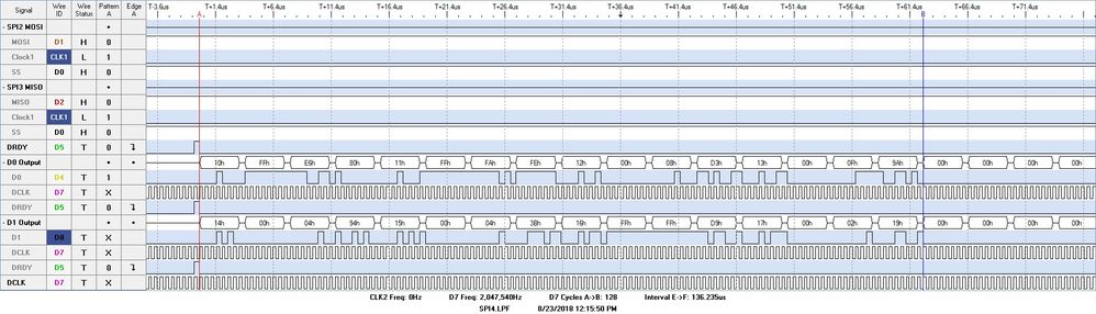

I am using an ADC that has two Data Outputs (DO and D1). Ch0 - Ch3 are output on D0 and Ch4 - Ch7 are output on D1 The maximum DCLK would be 32.768 MHz and the maximum Output Data rate would be 64KHz. Is it possible that the XGATE could read the simultaneous data on D0 and D1? Each data stream is 128 bits deep (4 channels * 32 bits per channel) The image below is the output using DCLK of 2.048MHz. If this can be done with the XGATE, is there an AP Note or something to get started.
