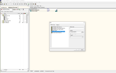

As you know that the MC56F803x is a bit old(released in 2009 year), the bootloader can be generated with the CodeWarrior for DSP56800E ver8.3 as the following screenshot, after you click File->New->Processor Expert Examples Stationery
Then select the bootloader, the tools will generate the bootloader code based on the selected DSC derivatives.
But the CodeWarrior for DSP56800E ver8.3  has issue if you run it on Win 10 OS, because the tools has not updated for a long time. Pls get a PC with Win XP OS and install the CodeWarrior for DSP56800E ver8.3 tools.
Hope it can help you
