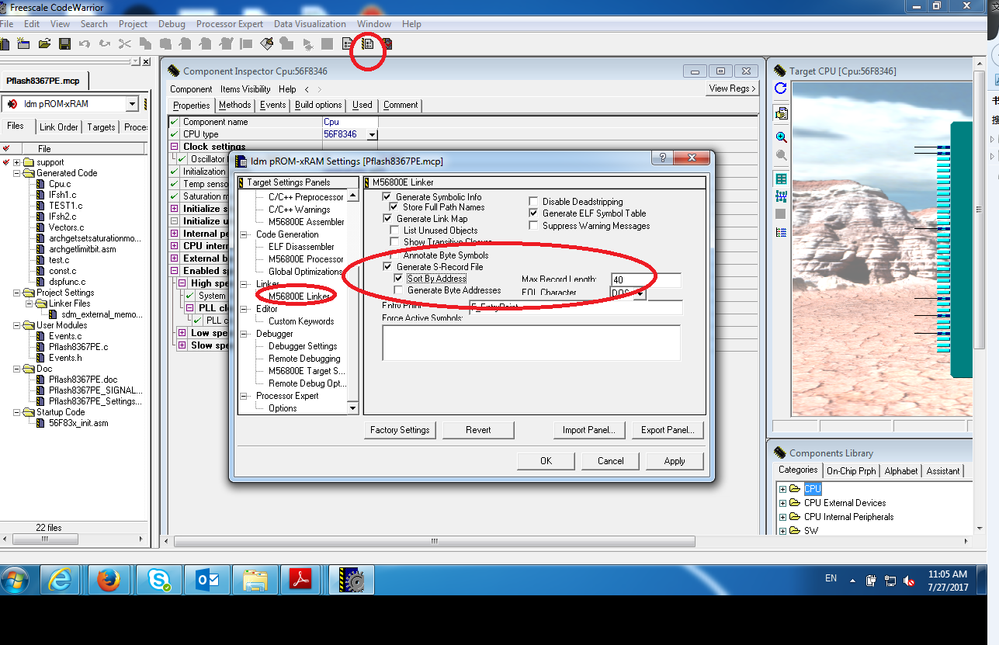

Hi, Bob,
I do not think that "generating S recorder file" is related with the SDK/LDM modes, it is dependent on the tools configuration to generate the S recorder file.
I suppose you use CW for DSP56800E ver8.3 tools, pls see the following configuration, then recompile your application project, it is okay.
I attach the figure of configuring to generate S recorder file.
Hope it can help you
Xiangjun Rong

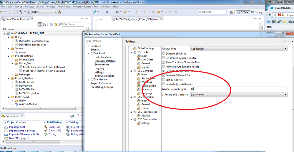

bob_s
Thank you for your response, Xiangjun.  Pardon the lack of clarity, but I  was  using CW10.7, and for some reason my project (since I was picking up a project from another programmer who left) settings got messed up.  I have that now configured where I can generate both S records and .elf filles correctly for both LDM and SDM models.

xiangjun_rong
hi,
if you use CW for mcu ver10.x, pls check the screenshot which tell you how to generate S Recorder file.
Xiangjun Rong
