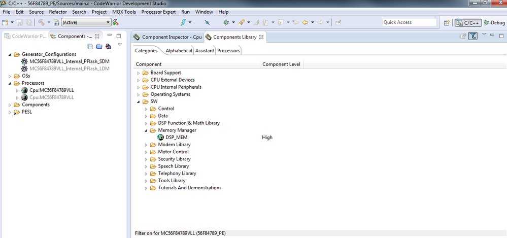

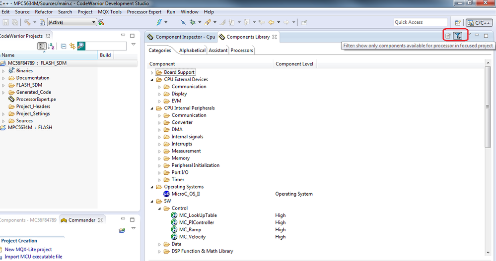

TICS_Fiona
I cannot find FAT_Filesystem component in CodeWarrior v10.6.3. Could you please press down the Filter button which is at the right-top of ‘Component Library’ View? Please see below.
Is FAT_Filesystem component displaying in the Component list on your side? Could you please attach a screenshot? Thank you very much!
In addition, User can install latest update in CodeWarrior 10.6 from CodeWarrior "Help" Menu->Check for Updates. Or review the link below for how to install update:
https://community.freescale.com/docs/DOC-103415

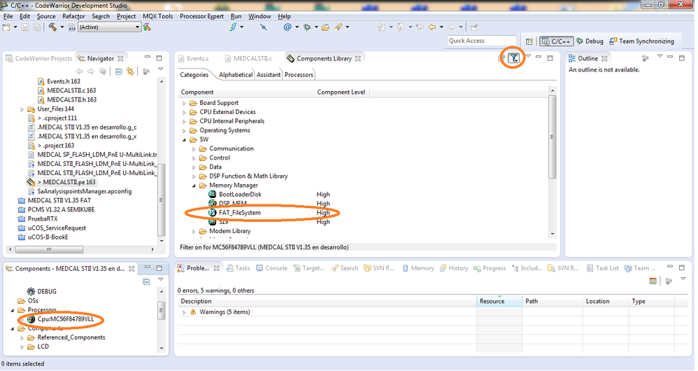

cabl
Thank you very much Fiona.
I had already installed all the updates. The component is under SW/Memory Manager.

TICS_Fiona
There is only 'DSP_MEM' component under "SW->Memory Manager" category for 56F84789:
If you create a new project for 56F84789 from <File> menu -> New->Bareboard project, enable Processor Expert, then can you see the 'FAT_Filesystem' in Components Library?
How to reproduce the problem?

cabl
Yes, if I start a project from scratch I can see the FAT component. Maybe someone (I´m not the only one who uses this computer) installed extra components?
Does Freescale+PE have an official FAT FS component? If it doesn´t, does at least have FAT libraries for this DSC?

cabl
Hi.
Finally I think I´ve found the component. It´s from MCUONECLIPSE, so I guess it´s not an official PE component and I can´t expect any support from PE or Feescale.
