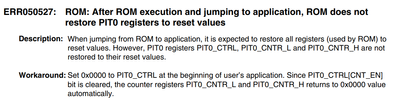

I'm not sure which development template you are working on, the one with MCUXpresso config tool, or the one without it?  There's a way to bypass ROM during the startup, which can be easily implemented through the tool.
Regarding PIT, please check an erratum for the this chip, PIT is used in ROM, but not reset after ROM execution.
There should be no big issue migrating a bootloader from 82xxx to 81xxx. I think there are some details that I'm not aware of, please contact me directly so I can provide support.
