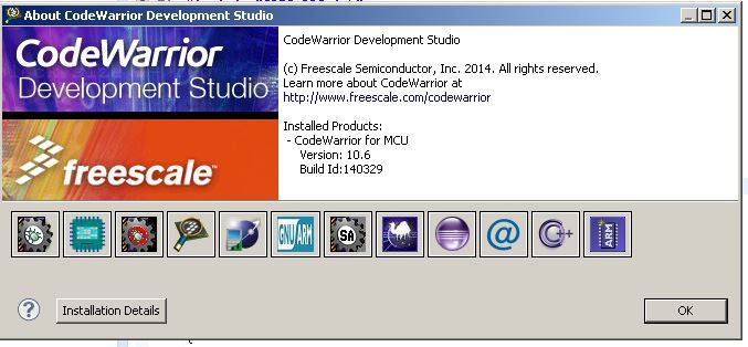

michaelhufnagl
Hy John !
,.sorry for my late reply I'm using CodeWarrior 10.6 (see screenshot attached)
the PE-Micro debugger i'm using is the USB-ML-UNIVERSAL (green housing).. what do you mean with UMULTILINK ?

johnlwinters
CW seems correct, but make sure you download all the updates as well.  This is the MCU edition, version 10.6.  But the updates are important as well.

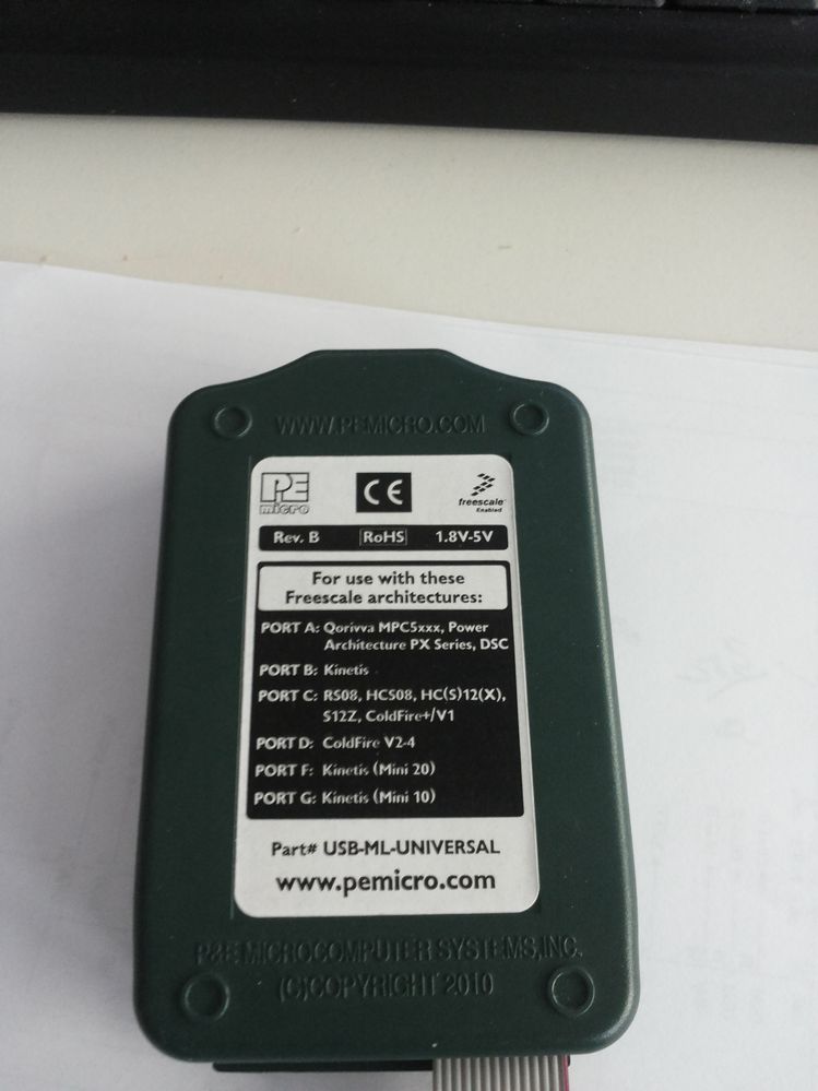

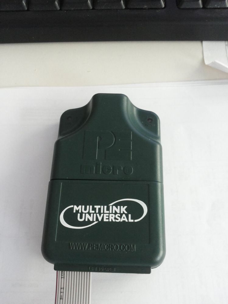

michaelhufnagl
Hy John !
,. it's the green one.. don't worry 'bout the red-ribbon on the wrong side.. just connected the cable for the photo...
8,681件の閲覧回数
johnlwinters
This is the correct UMULTILINK device.

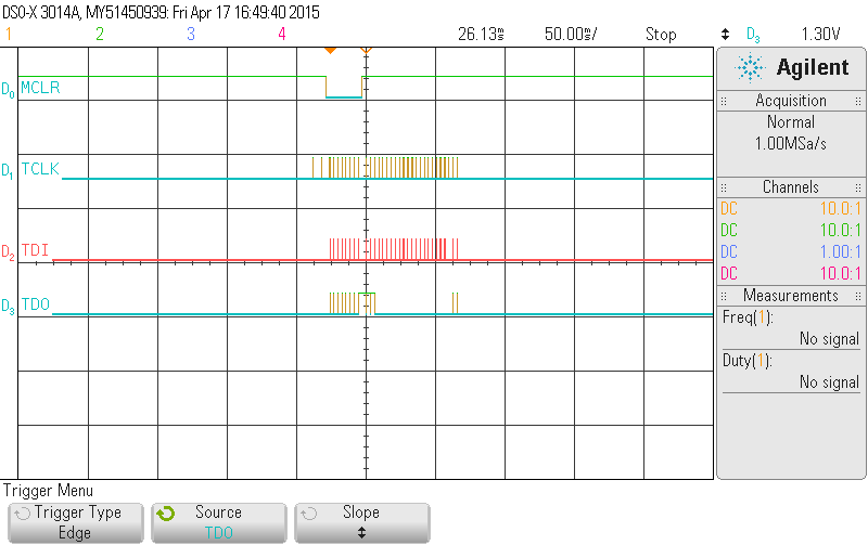

michaelhufnagl
Hy John !
,. bad news first,. i'm still not able to flash the cpu.
but i've connected a logic probe and referring to the p&e manual this screenshot looks quite good...
anyway.. code warrior says the cpu is protected and the connection dialog pops up.. not beeing able to flash,..
could you please have a look at the screenshot and sahre your opinion ?
Thank's in advance !

johnlwinters
This LA diagram looks OK, but I'd like to see analog scope shot of VDD, RESETB, and VDDA.
What was the result of your examination of the power sequence?  It is very important not to power the reset pin prior to applying power to VDD and VDDA.
Otherwise, the flash parameters may be errased and it may appear to be locked, when in fact, it will need to be sent back to the factory to have the flash parameters restored.
