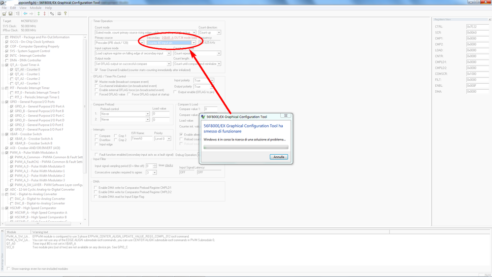

I'm using the Quick start for MC56F82323 release 2.6.31.0
If i try to do the setup on the "QT_A0-Counter_0"  on the  "secondary input"   "Counter #3 input pin"
the system crash like the attached image.
Solutions ?

Sorry for the waiting. I got the solution from the developers.
Attached file is fix of this issue.
You can apply the fix by copy this file into C:\Freescale\DSC56800EX_Quick_Start_r2.6\tools\gct\ folder
Fix removes option to select input pin 3, because pin is not in this package.

Hi Mr. Xin Kuang,
The cpu is the MC56F82323 thank.

TICS_Fiona
I reproduced the problem with CodeWarrior v10.6.5 and DSC56800EX Quick Start v2.6.31. I have contacted the developers for this issue, and will reply again as soon as I get any progress on it.  In addition, I created a SR#1-4061015762 for you to trace this problem.
