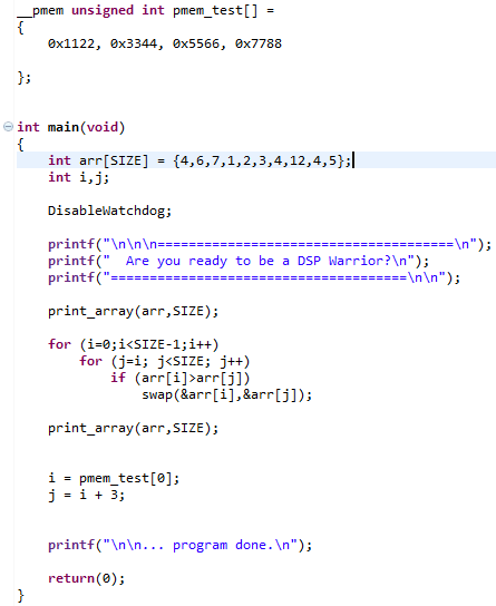

HI,
I cannot get an array into program flash.  Using a new Bareboard project for 8345, I modified it as follows:
I get this compile warning:
It is clearly not working right:

Mike_d
If I do the same in a Processor Expert project it works right.  There is some clue here.
1,972件の閲覧回数
xiangjun_rong
Hi, Mike,
Obviously, the problem is dependent on the compiler rather than the processor, I have tried on CW for mcu ver11 and TWR-56F8400, the result is correct, I have not the warning message either.
How about update your tools to ver11?
