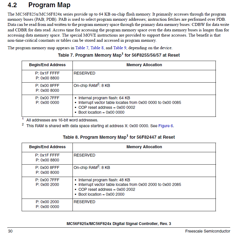

we are using 56800E software to program controller (MC56F8247) with windows 7 os now we upgrade our pc to windows 10.now we are using freescale dsc flasher to program controller but we have facing error.    (ERROR 1:The Address 0x000080 is out of range given the space memory space parameters.)

Hi, Ashok,
Pls refer to the memory map for MC56F82xx,  the P memory ranges from 0x0000 to 0x7FFF, the 0x8010 is outof P flash range. Pls check your  link file, which define the memory space.
Xiangjun Rong
