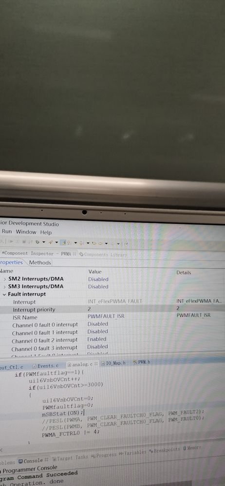

Hi,all I'm coding the PWMA fault isr .But the ISR can only execute one time.WHy?
i set up the isr by PE.The following is my ISR code.Pls give me some advice.
////////////ISR CODE////////////////
#pragma interrupt saveall
void PWMFAULT_ISR(void)
PWMA_FSTS0 |= PWM_FSTS0_FFLAG2;
if(PWMfaultflag==0)
mSBStat(OFF);
PWMfaultflag=1;
PWMA_FCTRL0 &= ~(4); //disable fault interrupt
////////////////Clear isr flag every 3 seconds////////////////////////
if(PWMfaultflag==1){
ui16VsbOVCnt++;
if(ui16VsbOVCnt>=3000)
ui16VsbOVCnt=0;
PWMfaultflag=0;
mSBStat(ON);
//PESL(PWMA, PWM_CLEAR_FAULTCH0_FLAG, PWM_FAULT2);
//PESL(PWMB, PWM_CLEAR_FAULTCH0_FLAG, PWM_FAULT0);
PWMA_FCTRL0 |= 4;

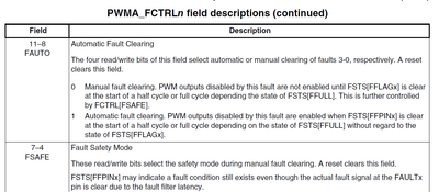

xiangjun_rong
Can you use the manual fault clearing mode? In the PWMA_Fault ISR, you can set a flag. in the PIT ISR, you can check the flag, if the flag is set, you can count a variable in the PIT ISR, when the variable reaches a fixed value, you can clear FSTS[FFLAGx], clear the flag, then the PWM signal will recover.

david_lin
Yes,You are right.THis is also my style to realize this function and it can work.

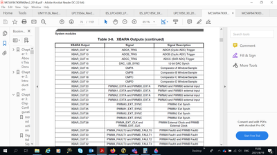

xiangjun_rong
First of all, pls make sure that the PWMA_Fault signal(PWMA_FAULT2) has to happens, in other words,  the PWMA_Fault signal must appear periodically so that you enters fault ISR multiple times. You use MC56F84768 with 80 pins package, from the RM of MC56F847xx, there is not dedicated pin PWMA_FAULT2 for 80 pins package, so you have to provide the PWMA_FAULT2 via crossbar via XBAR_OUT31.
Can you tell us how you provide the PWMA_FAULT2 signal?
XiangJun Rong
80 — — GPIOG4 PWMB_3B PWMA_FAULT2

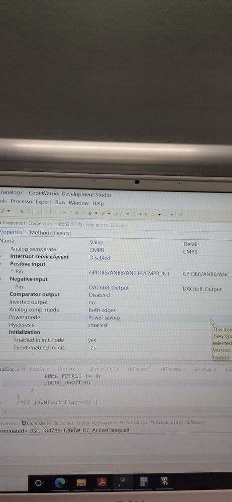

david_lin
HI, the PWMA_FAULT2 signal is the CMPB output with positive input GPIOB6 and negitave input DAC6bB-output.

4,425 Views
david_lin
CMPB  trigger PWMAFAULT ISRCMPB trigger PWMAFAULT ISR

david_lin
This is my PWM FAULT ISR setting up.
