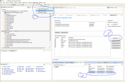

As it's designation 56800E Flash Programmer implies that the tools just writes code/data to flash instead of reading it to a flash, furthermore, reading flash to a file may infringe the code IP, so it is not a main function. I think the CodeWarrior for MCU tools provides the function.
Click the "Add Action", there is "Dump Flash" option, you can download memory to file with the option.

Abdulkerim
No problem for a computer system
Because my computer is running on Windows 7 64 bits mainly
But I didn't see that the software had a "reading" icon.
I need to write and read memory for that controller
MC56F8006, 13, 23, 34 and MC56F82746V
