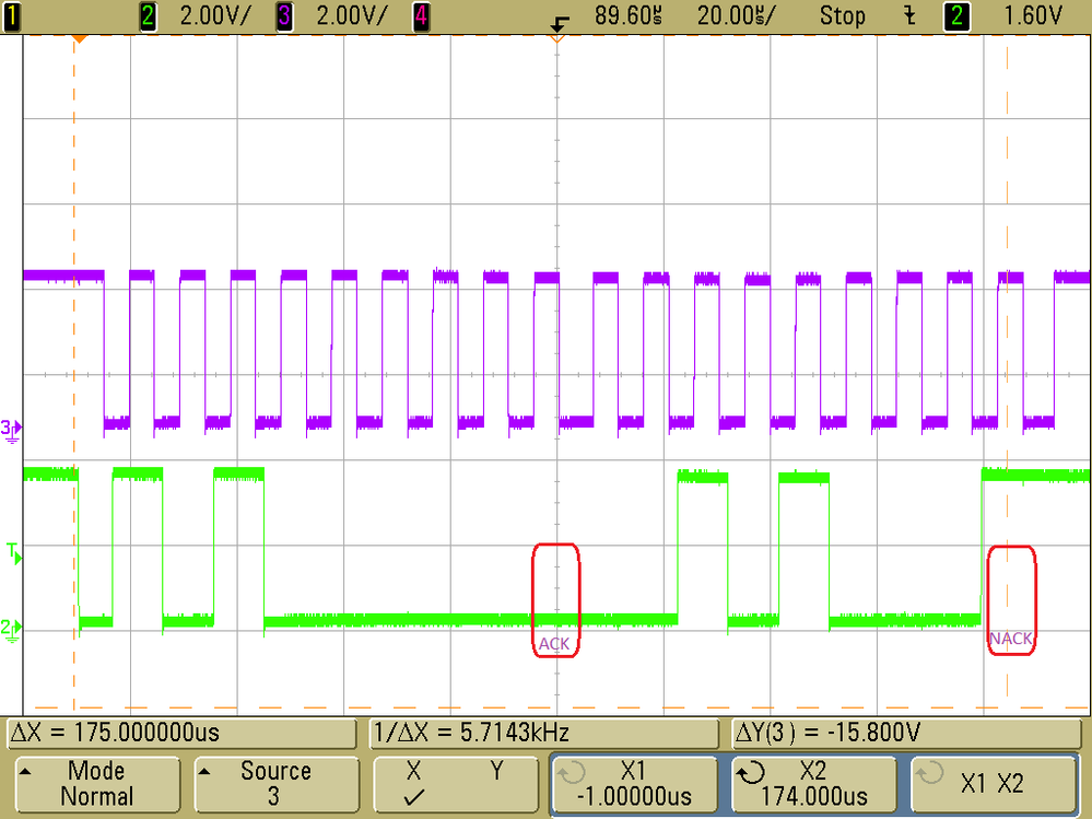

Thanks John's prompt response.. Attached is the waveform that I captured at SCL and SDA signal of I2C0 module.
You can see that ACK can be obtained after master sends Device Address to slave, but NACK will be obtained after master sends any Memory Address (0x28 for example).
I tried to change Device Address rather than 0x5? (? means 0 ~ F), the response can get NACK. So, the configuration should be OK for I2C0 module. Compared with I2C1 configuration, there is no distinct difference on each register respectively.

The waveform is same as the privious reply depicted, in which the 9th clock of 2nd byte will get NACK response.
