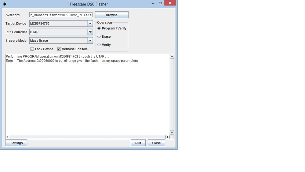

I have an application running on the MC56F84763 which I normally load to the IC using the Codewarrior Eclipse IDE 10.6
I would like to begin using the DSC Flasher program to load the program to the DSC, but I continually get an error every time I tried to program with DSC Flasher.  The error reports:
Error 1: The Address 0x00060000 is out of range given the flash memory space parameters
After digging through the DSC Flasher application, I know that MC56F84763 uses the memory model in MC56F84769_mem.tcl.  I have compared the memory locations and spaces that are default in the file mentioned and my application.  They look the same, and so I expect them to be compatible.
My application sets the security bits on the Flash memory so that the program cannot be read after writing.  I am wondering if anyone knows - are the security bits being locked the thing that is throwing this error in DSC Flasher?
Thanks for the help!

This is a known issue that DSC Flasher does not support the S-record file which contains data in Program RAM. You can manually remove the data line in Program RAM from S-record file to work it around.

Thank you, Xin Kuang and Luca Gotti!
This is confirmed to work.  I removed all of the lines manually out of the .S file at line 0x60000.  The DSC Flasher then programmed without any warnings or errors.

I confirm that i've solved the very same problem in that way ( manually removed the s-rec lines starting from 0x6000  ) .
However, it would be nice it Freesclale fixes this very annoying problem !!
Also it would be nice if the programming times would be shortened :  The old flash_over_jtag utility was really faster the DSC Flasher !!!
