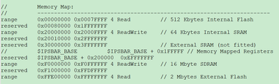

Hui_Ma
Nice to hear the issue had been resoved.
MCF5282 has internal 512KB Flash memory, which is called CFM (ColdFire Flash Module). Detialed info at MCF5282 user manual chapter 6.
I attached below M5282EVK board memory map for your reference:
11,083 Views

I could move forward, one issue seems was caused by setting FLASHBAR,
this register is intended for the internal flash base address, but 5282 does not
have any internal flash. Setting it, especially executing with the BDM debugger,
(not sure if it does any difference), was causing next line-f issues.
Anyway, now i am stuck in another issue, i don't see any CS0 toggling accessing
the external flash
