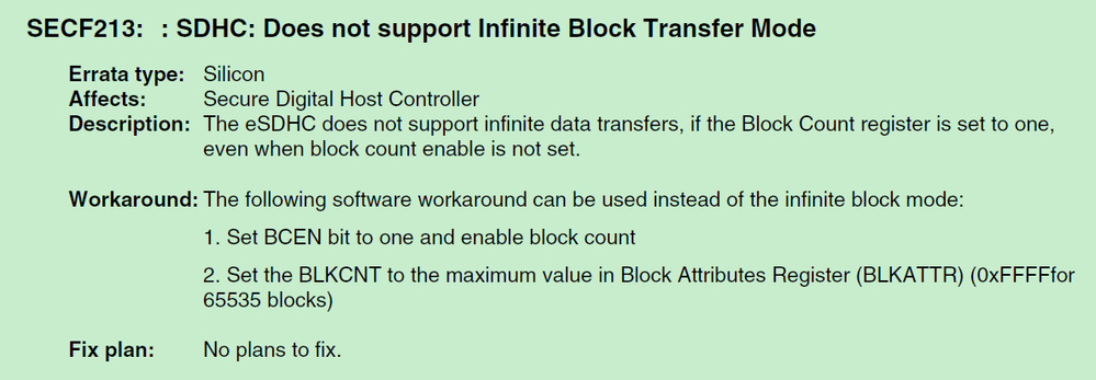

From the latest MCF54418 chip errata, there with below record:
Please refer and apply Workaround with CMD18 command.
Wish it helps.

Hui_Ma
Wish it helps.

Hi Mike,
speciaL thanks, it was very helpful solved all.
Best regards.
