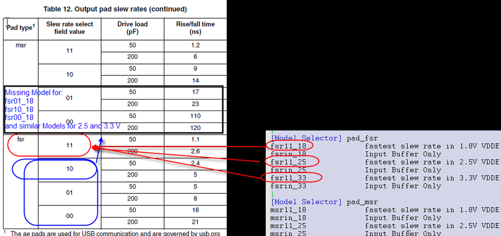

Looking at the SR Control register let's assume, that there were 4 different IBIS IO Models to simulate different slew rates  within a given voltage rail lets say 3.3V
In the Ibis Model the Model Selector pad_fsr does only support Models  for the voltages 1.8, 2,5 and 3,3V
How can Slew Rate control be established in simulation within the supported IBIS IO's / Model Selectors in the ibis File. Typycally these Models were expected whithin the default Model Selector pad_fsr
I've seen there were pad_msr and pad_ssr  Model Selectors available but I haven't found a hint that these can be used for the physical Pin F3 also.

Thank you for the info,
we have got the model under an NDA, so I could not share it.
As you can see there were also:
ssr ( Slow Slew Rate )
msr ( Middle Slew Rate )
fsr ( Fast Slew Rate)
Models for the 1.8, 2,5 and 3.3 Voltages.
Within the Flexbus Slew Rate Control Registers (SRCR_FB4) there are the folling four combinatination available:
SRE_x Slew rate control.
00 Lowest slew rate
01 Low slew rate
10 High slew rate
11 Highest slew rate
I missed the IBIS  Models for the three patten (10,01,00) in the Slewrate Control Register.
