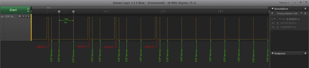

If I remove the debugger and simply power up my target, I see that it still struggles to boot, leading me to think that this NOT just an issue with the BDM, but an overall issue with the COP system.
I added more "instrumentation" by configuring an output pins to toggle unique patterns at different times. At POR the output toggles 5x. When the reset pattern 0x55 0xAA is written to the SRS, the output toggles 1x.
With these patterns I can confirm that MCU resets several times before it is able to "get going". For example, the reset times are 715 ms, 464 ms, 715 ms, before the application is able to run, all of which are under the COP timeout of 1.024 ms. Within the reset times, the maximum time between the writes to the COP is 250 ms.
Once the target is running, I'm able to see from my target's GUI that the only reset source reported in the SRS is the COP bit.
I've attached an annotated screen capture from my logic analyser that illustrates the timing.

TomE
Specialist II
I missed that part on the COP interaction with the debugger. That is a simple and sensible implementation.
Your CPU is getting reset, that much is certain. I think we can trust the SRS register when it says the source is the COP.
That must mean that either the COP isn't being restarted properly, it is biting due to some other "violation" or the clock is running too fast.
The intervals between the CPU resets are a lot less than the expected timeout (1 second). If the COP restarts weren't working I'd expect the CPU resets to be 1 second apart.
The COP will reset the CPU if it is programmed in "Windowed" mode and the resets are outside the window. This is easy to check and isn't happening. The COP will also reset the CPU if any value other than "AA" or "55" is being written to the SRS. Is it possible you have an uninitialised variable or pointer somewhere in your code, and it is writing to the SRS? This could keep happening until the variable ends up with a value that has it not writing to the SRS address.
The "1kHz LPOCLK" could be running fast. Slow clocks (like 32,768 watch crystals) are notorious for being sensitive to any electrical noise, as noise pulses are seen as extra clock transitions. Check the power supply for any strange noise. Add some more capacitors. Power the CPU from something else. Check all the VDD and VSS pins (all 8) to make sure none are floating. Check for a capacitor on VREFO if the reference is enabled. Can you get to CLKOUT? If you can you can program SIMCO to output LPOCLK on that pin so you can watch it with an oscilloscope to see if it is running at the right speed.

markthedark
Hi Tom,
Thanks for the thorough list of suggestions. Your critical-thinking skills are *very* much appreciated.
I sent LPOCLK to CLKOUT and it always looks clean. The output frequency is about 1.023 kHz. I had a moment where the target really struggled to get going, and the output was consistent the entire time. We can rule that out.
You suggested checking to see if there is an uninitialized pointer writing an invalid value to SRS. I redefined my KICK_WATCHDOG() macro to be blank, disabled the watchdog module and then set a debugger watchpoint to halt on any writes to the SRS register. The watchpoint never halted. To be sure it was working, I manually wrote to that memory address through our background terminal and it did halt, meaning the watchpoint was working. As an additional check, I re-enabled all watchdog code, BUT changed KICK_WATCHDOG() to write an invalid value, and that restarted the MCU instantly, verifying again that the watchpoint is working. I *think* we can rule that out.
