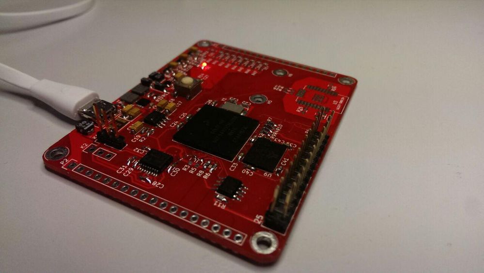

angelo_d
Senior Contributor I
Hi Tom,
uhm, i get the ddr2 init of that tower module from u-boot, had to change some bits as for the terminations,
but the rest seems to work reliably with a bus clock of 240Mhz. I hope i don't have to change anything else.
I like this architecture, and, jfyi, i am custodian of u-boot branch together with Alison Wang (Freescale, now NXP likely).
Still learning a lot btw.
I designed with kicad and soldered all at home this mcf54415 based board below. All opensource way, as the similar "amcore" board in my www.sysam.it site. No businness on these boards actually.
So actually ddr2 init works,
so i am quite happy. In next days i should see linux running on this board, hopefully.
Many thanks for now.
angelo
