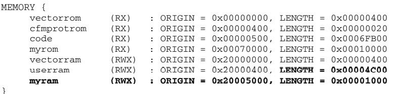

Hui_Ma
Please try to change the lcf file with memory size.
For example:
Mike
