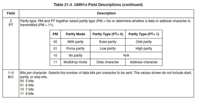

Dear Sir,
Processor Expert generates different registry addresses, as it was done before for UART having
#define MCF_UART_UMR_PM_MULTI_ADDR (0x1C). I need setup it for using RS485.
PEx creates me for UART with even parity
void AS2_Init(void)
SerFlag = 0x00; /* Reset flags */
/* UCR1: ??=0,MISC=3,TC=0,RC=0 */
setReg8(UCR1, 0x30U); /* Reset UART transmitter */
/* UCR1: ??=0,MISC=2,TC=0,RC=0 */
setReg8(UCR1, 0x20U); /* Reset UART receiver */
/* UMR11: RXRTS=0,RXIRQ=0,ERR=0,PM=0,PT=0,BC=3 */
setReg8(UMR11, 0x03U); /* Set the UMR1 register */
/* UMR21: CM=0,TXRTS=0,TXCTS=0,SB=7 */
setReg8(UMR21, 0x07U); /* Set the UMR2 register */
/* UCSR1: RCS=0x0D,TCS=0x0D */
setReg8(UCSR1, 0xDDU);
/* UBG11: Divider_MSB=0 */
setReg8(UBG11, 0x00U);
/* UBG21: Divider_LSB=0xF0 */
setReg8(UBG21, 0xF0U);
HWEnDi(); /* Enable/disable device according to status flags */
How to modify UART_UMR_PM registry to make multidrop parity?

Regarding your inquiry, I am not sure if you have configured UART2 to work in interrupt mode, to do this in user_config.h you need to enable ITTYC = 1. The MCF5282 only supports 5–8 data bits plus parity. The parity bit could be used as the 9th bit. There are the UMR1n[PM; PT] bits which it is in position to set up either for Force parity, or for Multidrop mode. In multidrop mode, the address character has the 9th bit==1 and data character has the 9th bit==0 (8bit character is assumed). Any way, this will require a change in the UMR1n mode register before a character is pushed to the transmit buffer. A change in UMR1n needs to perform RESET MODE REGISTER POINTER and RESET TRANSMITTER/RECEIVER commands (UCRn command register) in advance.
About UART UMR register setting, there with below info for your reference:
Qustion: There are two registers _UMR1 and _UMR2. But the have the same ipsbar-offset!!! How should this work?
Answer: There is one pointer to UMR1n and UMR2n registers.
The UMR1n can be read or written when the mode register pointer points to it
> After Reset of CPU
> After RESET MODE REGISTER POINTER command using UCRn[MISC].
After UMR1n is read or written , pointer points to UMR2n and can UMR2n can be accessed .
UMR2n access doesn't update the pointer !
I attached related code for your reference.
Wish it helps.
Mike
6,617 Views
Marceli2022
Hi Mike,
To avoid complexity, Init_UART component consist multidrop parity settings. Therefore it seems convenient to replace one line with:
setReg8(UIMR1, 0x00U);
/* UMR11: RXRTS=0,RXIRQ=0,ERR=0,PM=3,PT=1,BC=3 multidrop addressable*/
,which consist PM and PT bits. I believe it need be only done initially. After I can use other UART_Serial component parts. It could be good to components update. If it works it should be straight applicable to MCF5282 chip as well.

Here, I working with RS485 to communicate with Microchip PIC18F6720. In the chip RM datasheet (Table 21-3) description is Multidrop parity Address character or Data character type, which can be selected by PEx for use UART initial component. Does switching between both for address byte and data bytes need be done, or need to switch into Low parity type?
Marceli
6,236 Views
TomE
Specialist II
I don't know how it works.
Read Section "23.4.4 Multidrop Mode" of the User Manual. It gives a pretty good description of how you're meant to use the hardware the achieve the transmission and reception.
I suggest you also download the PIC18F6720 Data Sheet and read the USART section, specifically "18.2.3 Setting up 9-Bit Mode With Address Detect".
Reading both of those together (as they're the opposite ends of the same comms link) should give you enough information to work out how to use it.
It looks like your software does have to receive the "Address Byte" (in an interrupt routine), determine if "this device is addressed" and then switch to receiving the data if so. The whole protocol is an "efficiency hack" so that all devices don't have to spend time (and maybe battery power) receiving all data bytes. You could probably receive all data bytes and handle the protocol in software if you wanted.
