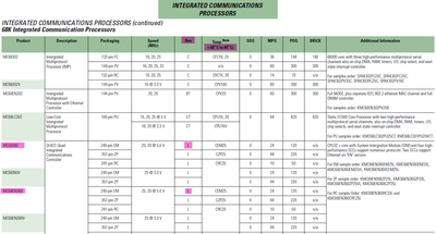

I found this picture which you post in "32-Bit Microcontrollers and Porcessors Quarter 2, 2006 SG1001Q22006 Rev 0", this is for product "MC68331", "MC68332", "MC68336", "MC68376", can this product number system rule apply to "MC68EN360CAI25L"?
Is "MC68EN360CAI25L" a industrial grade chip? The meaning of "EN" and "I" is not clearly indicated in this image.
Ethernet is not implemented in my application.
There is no direct replacement (pin to pin compatible or no hardware/software change) from MC68360CRC25L to MC68EN360CAI25L, however, I plan make a PCB to to convert the MC68360CRC25L package into an LQFP240 footprint suitable for soldering the MC68EN360CAI25L, can this work?

Please refer below picture with more detailed info. Both chips are consumer grade.
AI stands for packing type; L stands for Revision.
Yes, that should work if Ethernet module does not needed.
Just curious, why still consider to use so old product MC68360CRC25L as replacement? Why not using new product family(ARM Cortex M series based MCU)  with more powerful features?

Please refer below picture about 68K product naming rule:
MC68EN360CAI25L working temperature is 'C = -40℃ to 85℃', which is consumer grade.
About MC68EN360CAI25L replacement, unfortunately, there has no direct replacement (pin to pin compatible or no hardware/software change).
About MC68360CRC25L as MC68EN360CAI25L  replacement, there still with below product difference:
The MC68EN360 is the Ethernet version of the MC68360. The MC68EN360 is a superset of the MC68360. The Ethernet is available only on the MC68EN360.
Thanks for the attention.
