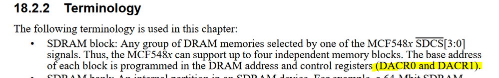

Once the SDRAMC is initialized, what is the address of the SDR/DDR memory?
If I understand correctly, the reference manual says you can set it with the DACRx register.
However, I can't find anything about the DACRx registers.
So my question is, what is the address of the DDR/SDR.  Do I set it up in the DACRx registers.  If so, are the DACRx registers memory mapped? Special registers.

If you go to www.nxp.com and type a phrase (like "DACR0 and DACR1") into the Search Box, you'll find a list of Reference Manuals that have that phrase in it.
Ones like the MCF5307 and others. These are the Reference Manuals that sentence you quoted was most likely copied from. But this chip doesn't have those registers. As you found and as Hui Ma answered, in this chip the data written into the CSBA field of the CSnCFG registers is used to match the CPU adddress - combined with the CSSZ field.

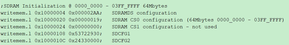

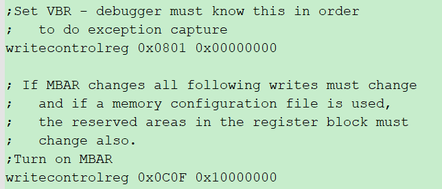

Please refer MCF5485EVB SDRAM configuration file with below info:
SDRAM memory address was set with SDRAM Chip Select Configuration Registers (CSnCFG) [CSBA] bits:
I attached <MCF5485EVB_SDRAM.cfg> file for your reference.
