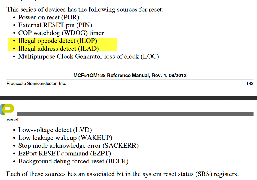

ZhangJennie
Hi Jozef,
According to reference manual. all the reset sources are listed below:
https://www.nxp.com/docs/en/reference-manual/MCF51QM128RM.pdf
If it's possible, please check SRS register for reset source of your case. and then shoot trouble accordingly.
SW resets are highlight above. If the reset is caused by SW, it may be ILOP or ILAD reset.
when cEraseConfigSector is defined as local variable, it is allocated in stack
when cEraseConfigSector is defined as global variable, it is allocated in RAM.
Thus can you please check the memory address of cEraseConfigSector ? Is it a valid address?
I know some customer had similar problem because of stack over flow, increase stack size in linker config file can fix the problem. You may also have a try.
Jennie Zhang
