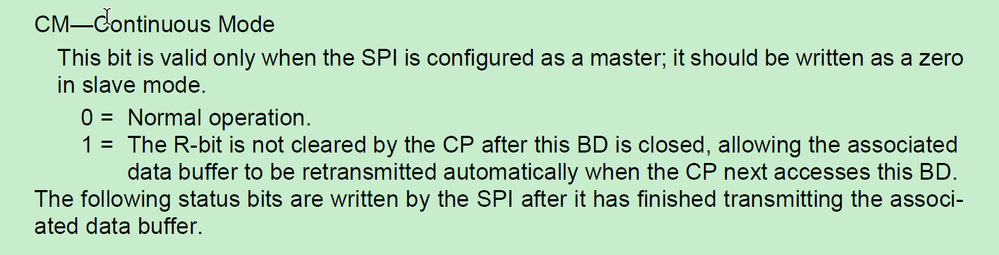

I am using MC68EN360 for one of the project. I wanted to interface ethernet chip (ENC28J60) using SPI with M68K.
I have configured the clock of SPI to 6.25Mhz and the SPI mode  '0' is set . The problem i am facing here is for the consecutive write (SPI write) there is a  delay of around ~500us(micro seconds) and same delay is observed for consecutive read (SPI read) as well. Due to this i am not able receive/transmit ethernet packets at faster rate.
I have looked into the usermanual of MC68EN360 did not find any information on the minimum delay between write/read. want to know is this the known behavior or any configuration issue.?

Hui_Ma
Please check MC68360 user manual chapter 7.12.5.5.1 SPI Receive Buffer Descriptor (Rx BD) & 7.12.5.5.2 SPI Transmit Buffer Descriptor (Tx BD) to set [CM] bit:
Wish it helps.

TomE
Specialist II
The "Continuous Mode" isn't what you want. As detailed in the manual, that lets the SPI interface continuously read something like an ADC, continuously reading a temperature or a voltage. The main code can then just read the "latest" value out of the buffer when it needs it.
Are your "Consecutive Reads and Writes" all from a large Buffer Descriptor? Are you asking the SPI controller to send a large buffer's worth? Or are you trying to send one byte at a time (unlikely)?
