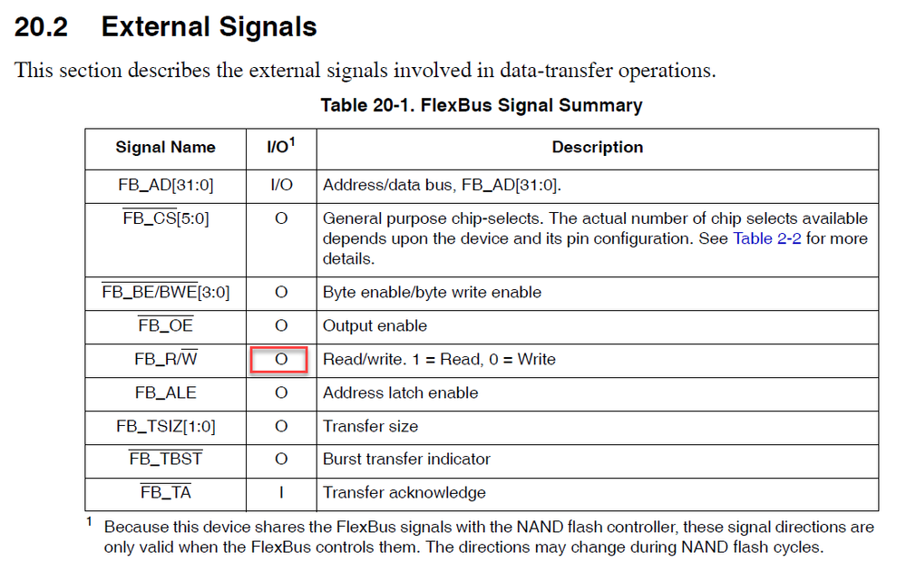

From MCF54415 Flexbus signals direction, the FB_R/W signal is output.
There need to add another pin as input function to realise that logic circuit.
Thanks for the attention.

Thanks for the reply. I think you are right. I probably need to use the R/W, OE, and the CS with some glue logic.
