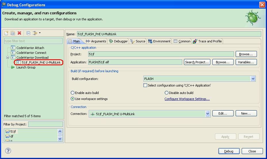

I have a TWR-MCF51JF tower system module and CW v10.1 with the MCF51Jx service pack. I've worked through the quick start lab, and I can build a project and run it on the target using debug mode through USB and the PE terminal tool. My next step is to program the processor flash using the Multilink Universal tool and the BKGD i/f on the processor. Can anyone point me to an example project or a tutorial that walks through this?

see below how to set debug configuration to debug code.
