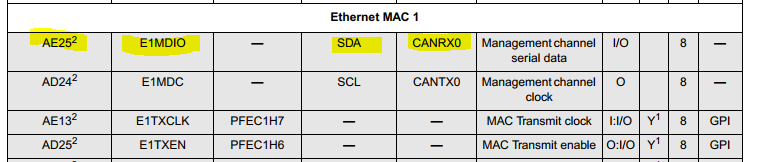

I think I found another error:
Table 2-1 on Page 2-6 (PDF page 50) shows the following assigned to bga pin AE25
However, on Table 2-2, page 2-15 (pdf page 59), it assigns the following:
This again appears on Table 32-1 pg 32-6 (PDF page996)
What is the correct I2C and CAN assignments for that pin?

miduo
Hello, Zach
Yes, you are correct. I am really so sorry for the errors in the manual. The correct pin function for AE25 should be SCL/CANTX0.
