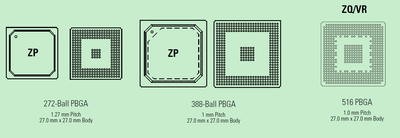

Thanks, Mike. This one is driving me crazy! The strange thing is NXP reports MC68F375BGMZP33 as PBGA-217:
https://www.nxp.com/part/MC68F375BGMZP33#/
And distributors report MC68F375BGMVR33 as the same:
https://www.digikey.com/en/products/detail/rochester-electronics-llc/MC68F375BGMVR33/12599906
Are both just wrong in this case? ZP = 272 pins despite the NXP product page?
I did find this with the help of your image: https://www.nxp.com/docs/en/product-selector-guide/SPSSG1006.pdf
Clearly ZP is PBGA, but VR is not identified on this older doc.
Thanks again Mike. Would love to hear some feedback on what I'm seeing on the pin count inconsistencies!

I could find internal product system that MC68F375BGMZP33 product with BGA217 package.
While, I could not find MC68F375BGMVR33 from product system, which should be obsoleted.
From my view, please follow the internal product system, which provide the updated package info of MC68F375BGMZP33 product.
Thanks for the attention.

Please check below 68K product naming rule:
The difference of both chips are package:
Wish it helps.
