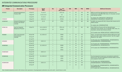

ForzaLavida
Any chance you have a part number breakdown, I'd like to know the differences between say, the mc68360cem25k and the mc68en36025l
3,208 Views
Hui_Ma
Please refer below picture about MC68360 product difference.
And below is 68K product naming rule for your reference:
Wish it helps.
