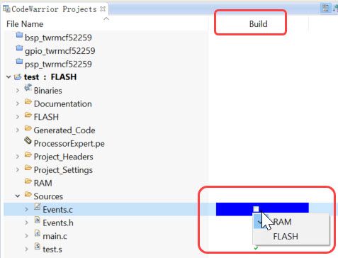

I was building my project on code warrior 11.1 I m working with the MCF5225x
I don't know if I did something wrong but now this symbol appears over my .c files
And they can't be selected for building process as the header files.
Pretty sure it will be something simple, but since I can't even define the symbol, I don't know what it means.
Thank you in advance

Please refer below picture, just mark which target you want to include related files.
Wish it helps.

Thank you.
It worked
