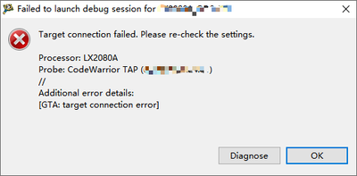

my platfom:
CPU:LX2080CA
DDR: MT40A1G16
FLASH:MX25UW51245G , flash is blank.
sysclk 100M。
hardware link status :us
e usb link codewarrior,and code  warrior link my board with JTAG
when I refer to 3.2 Working with bareboard application in D:Freescale\CW4NET_v2020.06\CW_ARMv8\ARMv8\Help\Getting_Started_for_CW_ARMv8.pdf to debug my board, it always report "target connection error",
then I refer to  8.6 Board Recovery in CW4NET_v2020.06\CW_ARMv8\ARMv8\Help\PDF\ARMv8_Targeting_Manual.pdf to modify Target Init File,
        USE_SAFE_RCW= True
        # Overridden RCW source
        TA.rcw.set_source(0x9F)
        # Overridden RCW registers will be added here
        TA.rcw.set_data({1: 0x586b6b18})
        TA.rcw.set_data({2: 0x24580058})
        TA.rcw.set_data({3: 0x00000000})
        TA.rcw.set_data({4: 0x00000000})
        TA.rcw.set_data({5: 0x00000000})
        TA.rcw.set_data({6: 0xc010000})
        TA.rcw.set_data({7: 0x00000000})
        TA.rcw.set_data({8: 0x00000000})
        TA.rcw.set_data({9: 0x30001a0})
        TA.rcw.set_data({10: 0x00002580})
        TA.rcw.set_data({11: 0x00000000})
        TA.rcw.set_data({12: 0x00000096})
        TA.rcw.set_data({13: 0x00000000})
        TA.rcw.apply()​
and refer to  https://community.nxp.com/t5/Layerscape-Knowledge-Base/LX2160ARDB-How-to-configure-a-new-flash-devic...    add new  flash config. change  Target Init File :
    fl.add_device({"alias": "xspi", "name": "MX25UW51245G", "address": 0x0, "ws_address": 0x18000000, "ws_size": 0x1FFFF, "geometry": "8x1", "controller": "FSPI"})
and my board hardware CFG_RCW_SRC[3:0] set to 4'b00xx.
when I click Flash Programer,It still report connection error.
and I tryed two Codewarrior Tap box, It shows same error.
Is there anything else I can check?

此问题已解决,是我们的硬件的有个jtag复位信号没接上。
还有一个原因是 TA.rcw.set_source()参考LX2160ARM手册的Hard-coded部分,这里只能填0x0/0x1/0x2。

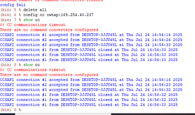

If  it's a bare board, please set the RCW_SRC[3:0] to hard-code.
When you connect the CodeWarrior TAP, should confirm the board could complete the Power-On Reset Sequence.
LX2160A Reference Manual,
4.9.5 Power-On Reset Sequence Detailed Description, step 24, System Ready State.
4.9.6 Power-On Reset Sequence Timing
And CCS could connect the CWTAP correctly.
In the ccs, please run:
(bin) 7 % delete all
(bin) 8 % config cc cwtap:10.193.21.52//(it's your CWTAP ethernet IP)
(bin) 9 % show cc
(bin) 10 % ccs::config_chain {lx2160a dap}
(bin) 11 % display ::ccs::get_config_chain
(bin) 12 % ccs::reset_to_debug
2,933件の閲覧回数
gec258
Thank you for your reply. we will check the power-on time sequence. my CWTAP box has been connected to the PC through USB.
On ccs, execute the show cc command according to the method you provided. After waiting for a while, the time out is indicated:
2,928件の閲覧回数
June_Lu
Could you ping the CWTAP?
What's your CWTAP version?
What's your CodeWarrior IDE version?
Please confirm update it to the CodeWarrior IDE version 11.5.12.
On the NXP website
My NXP Account->Software->Software Licensing and Support->View accounts->Product List->CodeWarrior for QorIQ LS Series ARMv8 ISA->
Please download update package
com.freescale.armv8.11.5.12.GA.Win.updatesite.221209.zip
Please open CodeWarrior from C:\Freescale\CW4NET_v2020.06\CW_ARMv8\fsl_eclipse.bat, and install the update package from Help->Install New Software->Add->Archive.
And then try the ccs command again.
You could reply the case in Chinese.
