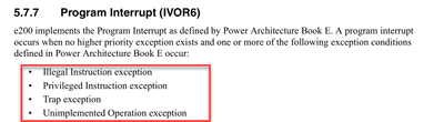

as you can see in the core reference manual:
https://www.nxp.com/webapp/Download?colCode=E200Z0RM
... IVOR6 is triggered when:

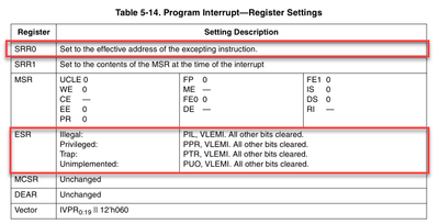

First step is to check core registers SRR0 and ESR to find the root cause:
Lukas

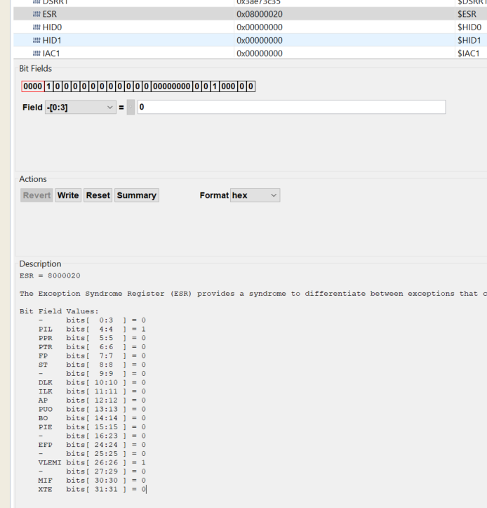

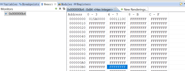

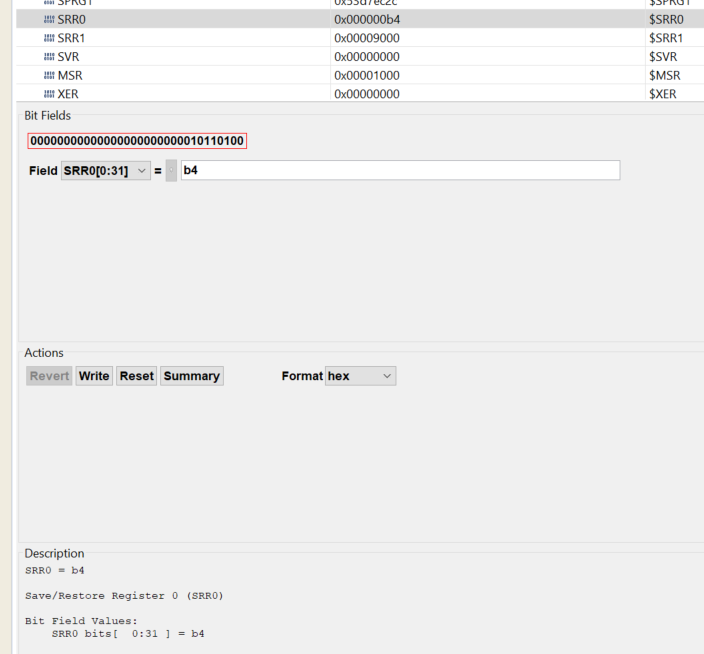

NXP_Leo
          I record the register data below as you said, it seems that i have no code at the address which error occurs.
3,087 Views
lukaszadrapa
OK, so it's not cause, it's effect only. In this case, I would focus on call stack to see which function was executed at that time and make deeper analysis. There's no simple advice for this, more debugging will be needed.
