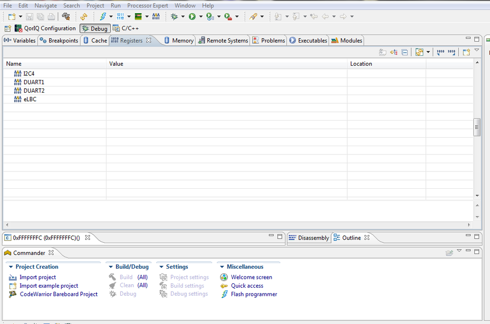

hi

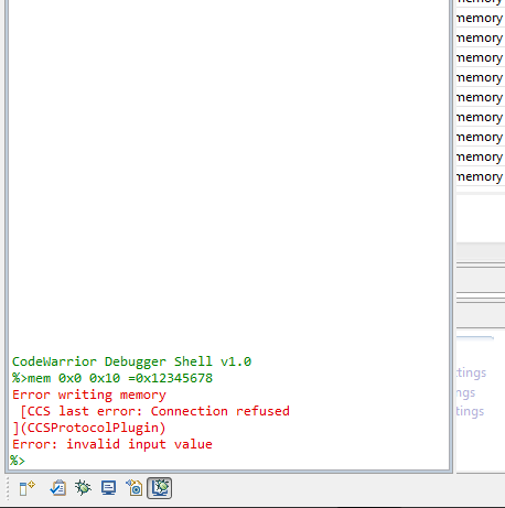

          we have a made a  p2041 vpx based carrier card i have installed code warrior  CodeWarrior for Power Architecture (Eclipse-Windows Hosted) v10.5 - SP1 with QCVS offline installation packages for CodeWarrior for Power Architectures Rev 4.4 and when i connect the processor through tap port it is getting connected the initialization file i have used is  p2041_sram _init .tcl file when i read the registers from the processor i am not getting any value and when i try to write to the memory location it is providing connection failed but when i select debug and select my project it is showing 100% connected what could be the problem?

Hello agxin j,
Probably there is problem during the initialization, would you please provide CCS log to me to do further investigation?
Please enable CCS log from "Run->Debug Configurations -><project>-core0_RAM_-Connect(Download)->Edit...->Advanced->Advanced CCS setting->Enable logging", and connect to the target from "Run->Debug Configurations-><project>-core0_RAM_-Connect(Download)->Debug”, the CCS log will be displayed in the console panel in CodeWarrior IDE.
If the CCS log in the console is truncated, please enlarge the console buffer from Window->Preferences->Run/Debug->Console->uncheck "Limit console output". (Please open the console panel from Window->Show View->Console, and if nothing displayed, please choose the correct session on the right top icon.)
Yiping
