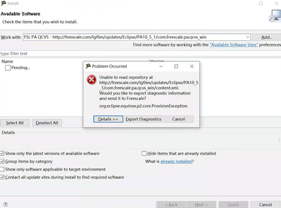

codewarrior 10.5 QCVS cannot download

can  u help me

I uploaded QCVS for PA 4.5 offline installation file https://support.nxp.com/s/case/5002p00002vUKYZAA4/community-codewarrior-105-qcvs-cannot-download?lan...
Please open CodeWarrior IDE and install this package from Help->Install New Software->Add->Archive.

Please use the following link instead.
FSL PA QCVS - http://nxp.com/lgfiles/updates/Eclipse/PA10_5_1/com.freescale.pa.qcvs_win

it is cannt access
