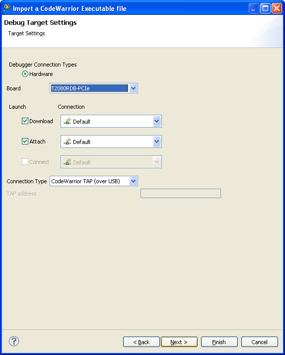

I am not able to link with U-Boot executable.

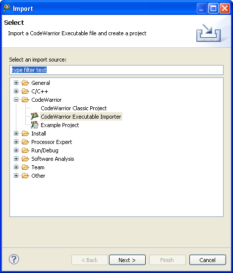

Kindly, help us to connect the u-boot executable in code warrior. Below, I mention my step to connect the code warrior.

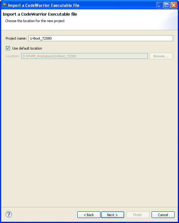

Step 1: Select File->Import and choose the  code warrior executable importer.
Step 2: Give the project name

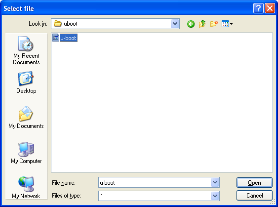

Step 3: Select uboot executable.
Step 4: Select Processor Type.
Step 5: In Target setting, select connection type as codewarrior Tap (over USB) and enable attach for launch.

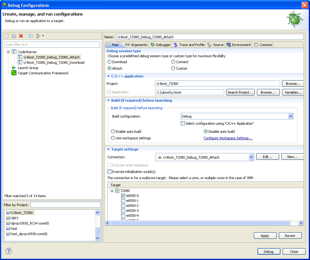

Step 6: select Core 0 for configuration and finish.
Step 7: In Debug Configuration, Remove all Initialization in attach configuration for debug.
Step 9: After attached, debug viewer two thread are created, one is shown reset vector address which is not ask for source for lookup and another thread is shown 0x0 address but it is ask for fdt.c file for source lookup.
Kindly help me, where i did mistake.

Hello Karunakaran Radhakrishnan,
As the AN4876 suggests in Section 4.2 Configure initialization file of project for debugging, you need to choose U-Boot initialization file. Copy below:

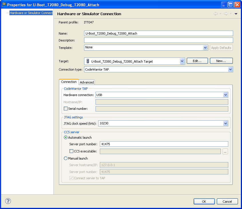

1. Choose Run > Debug configurations, to open the Debug configurations dialog.
2. Select Project name from the left pane and from the right pane, under Main tab – Target settings, select Edit.
3. From the Hardware or Simulator Connection dialog, select Edit to edit the target.
4. From the Initialization tab, browse to the location of U_Boot initialization file and add its location in the Initialize target.
5. Navigate to Memory tab and deselect Memory configuration.
6. Select OK to exit the Debug configurations dialog.

Default Reset vector Address is 0xFFFFFFFC. My Uboot reset vector address is 0xEFFFFFFC.
initialize nor flash in the script and change the PC reg to effffffc.
Now, I can able to debug using the u-boot source in code warrior.
